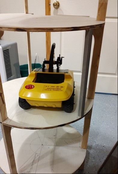

                    Made another small step forward. As I figured out what went where, I realized I'd need reinforcement somewhere for the cargo bay doors. So I added it today. Using a dremel, I inset a vertical pillar that will support the hinges for the cargo bay door. I wasn't sure if I wanted the door to slide or just hinge open. I decided to use a hinge because that was more retro and it would be a LOT less hassle getting a sliding round door to operate well. It needs to be kid-friendly rather than an adult collector thing.
                    Here's a pic of the vertical hinge support in the cargo bay.
                    Had to be sure it was offset enough to let us get the ATV out.
                    ATV will come out on a telescopic arm, and be lowered with a windlass/crank.
                    I haven't decided whether to make it kid-powered or electric.

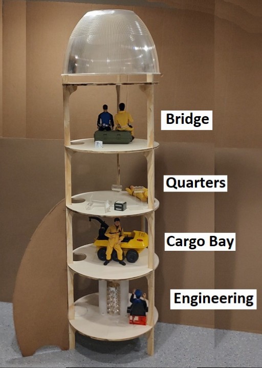

                            Work on the Joe Space Program is very slow.
                            It's at the bottom of the priority list around here, it seems.
                            I finished up access hatch work and did a mock-up of fin designs.
                            It'll have 3 fins, one on each vertical rib. The rear fin will be a slightly different shape... thinner... so it'll nestle in the corner of a room better.
                            Attached is a pic of the fin shape I liked the best; it's the cardboard template I'll use to cut the fins out.
                            Nothing sharp or pointy that'd hurt kids falling on it.
                            I'll attach the fins with "knock down" furniture fasteners (3 per fin), so I can remove the fins for transport.
                            Originally this was to be taller and actually stand up on high the fins like a 1950s retro rocketship, but my lovely bride reminded me that grandkids would probably try to climb it, so I made it lower for more stability and grounded the frame... also made the fins a little wider for stability. Next I need to cut the fins out of 5/8 plywood and shape them, then add the attachment points.
                            The skin is all cut out and ready to go. it's a huge piece of white sheet plastic.
                            I need to sand and paint the ribs/deck before adding the skin.
                            Waiting for a nice day outside for that work, because sanding is messy.
                            I found a nose cone; it is actually a light reflector for a warehouse ceiling light.
                            But it was the right diameter and is made of a really THICK plastic. Not sure... it might even be pyrex or something.
                            Looked like it'd work, so I picked it up. I actually got two, so if I try slicing this one in half and it breaks, I'll have a backup.
                            Got both "nosecones" for $10, so they were kind of a deal.
                            After I get the structure finished, the HARD part will start: the interior. It will HAVE to have sound effects and lighting, but not sure whether to do it old school or use a little Raspberry Pi SFX controller. Might just use a Raspberry Pi for the main screen on the bridge and run the REST of the lights on old-fashioned switches. But I can work on the interior and SFX details as time permits better than working on the BIG parts (sanding, painting, skinning it, etc). The kid I'm building it for just turned ONE, so I have some time! :-)
                            I still need to figure out some kind of a ladder. There are hatches in each floor, so all I need is the ladder. I thought about drawer pulls attached directly to the skin, but the cost of that idea was astronomical. A ladder with wooden sides and wooden rungs wouldn't look right. Maybe sides of aluminum "L" bracket and rungs made of small-diameter bolts with acorn nuts to hold them in? Dunno. Will hafta ruminate, cogitate, and contemplate.
                            Anyway, pic below. I stood up some sheet cardboard behind the rocketship to hide my messy Joe room shelves.
Name:	Joe Rocketship.jpg
