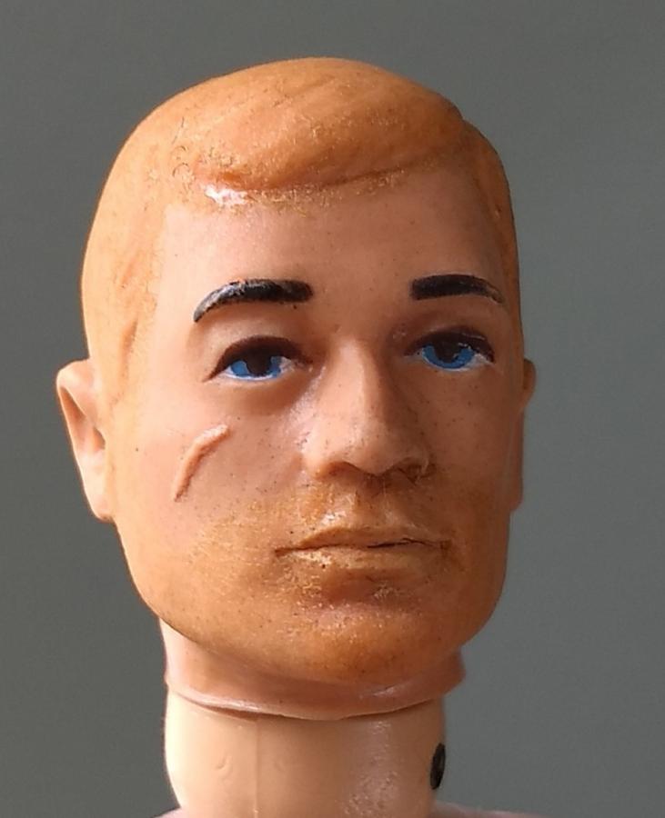

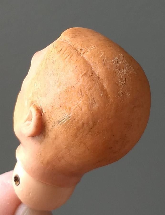

?? I soaked it for 2 days in plain old water. That softened up the glue enough for me to scrape most of the flocking off with a blunt fingernail. I soaked the head in a solution of 1/3 alcohol 2/3 water for about an hour last night, and that let me scrape the rest off. It seemed to work fine! Ready for flocking!
