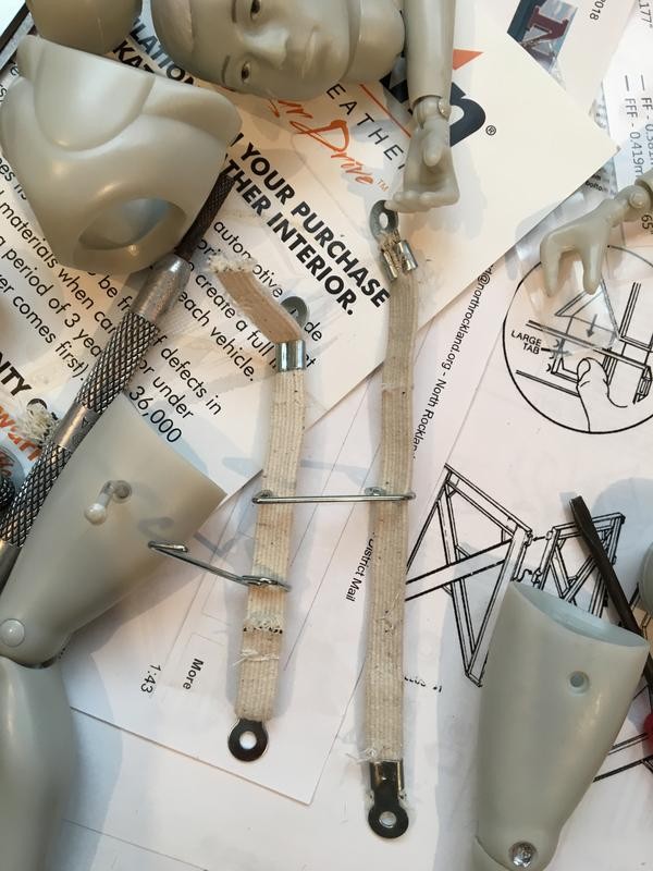

The first step is to relax the elastic that they crimped way too short.
cut the stitching, pull the elastic back through the crimp to the end (they don't crimp them that tight. That puts the elastic at the proper 6" length.
remove and straighten the buggered thigh pins caused by the excessive tight string job
heat and spread the thigh /hip opening for a better fit over the hip ball
original - expanded
Stupid amount of work for a brand new item, but I don't want them snapping or stress cracking in a year or two because of the bollocks job HasBeen did with these.

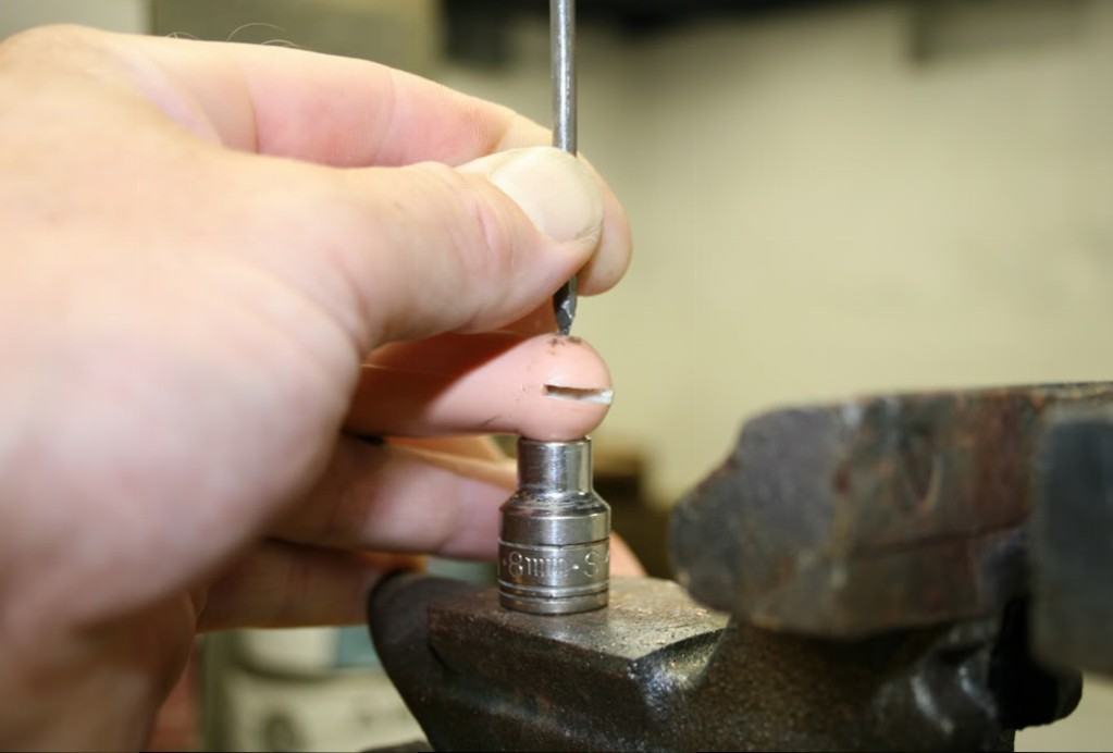

Just punch them out, using a socket to recieve it. Since it only takes a light tap to re-insert the pin, the paint really isn't touched.Originally posted by ATC View PostHow did you get the thigh pins out without scraping the paint off?
Old pic of regular Joe, illustrates process
That's another cool "how to" photo at lookforjoe..
For anyone who doesn't own a proper punch, they can use a large heavy-duty woodwork nail, just slightly blunt the pointed tip outside with a hammer on a solid surface, like the edge of your patio, or on a concrete paving slab.. also i've done a few AM pins in the past like your method, but I used a thin rubber/vinyl surgical glove folded twice to buffer any marks made to the AM limb from the wrench socket (place between the limb and socket) I did this as a precaution.
